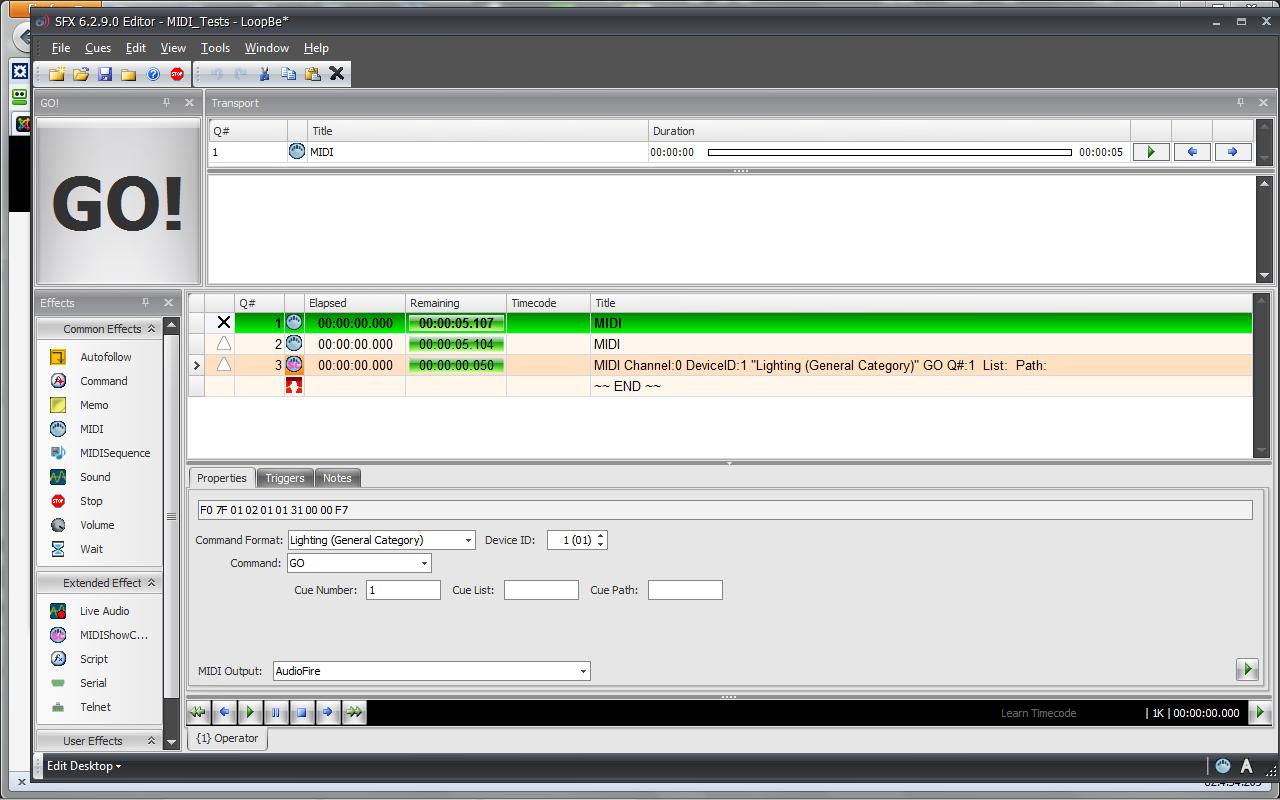

I think your 'Script' parameter for a step is the best method. DL should *not* send a generic GO. You have much less control over what you want to happen if you have worry about what the GO will do.
If possible, the new parameter field would offer
1) a drop-down to select 'type' of script (eg MSC, Other Sysex, Telnet, Serial, whatever)
2 If eg MSC is selected, then a seies of Drop-downs to select eg Device ID, Commands, Cue Number, etc. That way, people who are less 'MIDI-savvy don't have to worry tto much about writing Sysex.
(I will try and attach a screenshot from SFX MSC Cue proprties window to show what I mean)

Hi Nicolas,
I've installed the 3.0.6 Alpha. Observations:
The STOP and RESUME commands work as they should, ie STOP on a cue with WAIT pauses Wait and does not run TI/TO, and RESUME restarts Wait; further STOP/RESUME command do properly, and STOP/RESUME on TI/TO work as they should;
The GO Q Number(Integer) and Q Number (Decimal) work ok
BUT - In SFX6, a GO with *no* cue number *does not work*
In SFX6, a GO with *no* cue number looks like this:
F0 7F 00 02 01 01 00 00 F7
ie, it insists on putting in the two delimiting 00's (which are used when specifying CUE LIST or CUE PATH), and DL will not accept this - it will only accept F0 7F 00 02 01 01 F7 (I tested with Bome's SendSX). I know DL does not have this, but would you allow the MSC command set for DL to accept these delimiters please. (When using SFX6 with hardware consoles, I sometimes don't put cue numbers into MSC GO commands as consoles can start numbering differently, or not allow point cues)
Otherwise, it's looking good...
Regards,
