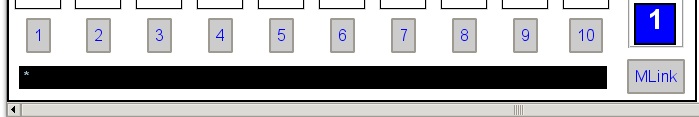

15 years 4 months ago #2796 by sl1200mk2
Replied by sl1200mk2 on topic Re: 3.0.6 (Release)
i've just tried and in fact you're not obliged to double-click on the star (see the bottom left of joined picture), you can double-click on all "zone"
maybe there's something wrong on windows...
15 years 4 months ago #2799 by samir
Replied by samir on topic Re: 3.0.6 (Release)
sl1200mk2 wrote: i've just tried and in fact you're not obliged to double-click on the star (see the bottom left of joined picture), you can double-click on all "zone"
Ahaa!!!
Got it...
So it wasn't Windows... only with my brain...
Can I echo @totoine - Seeing the Page Names in the Page List would be good... :whistle:
