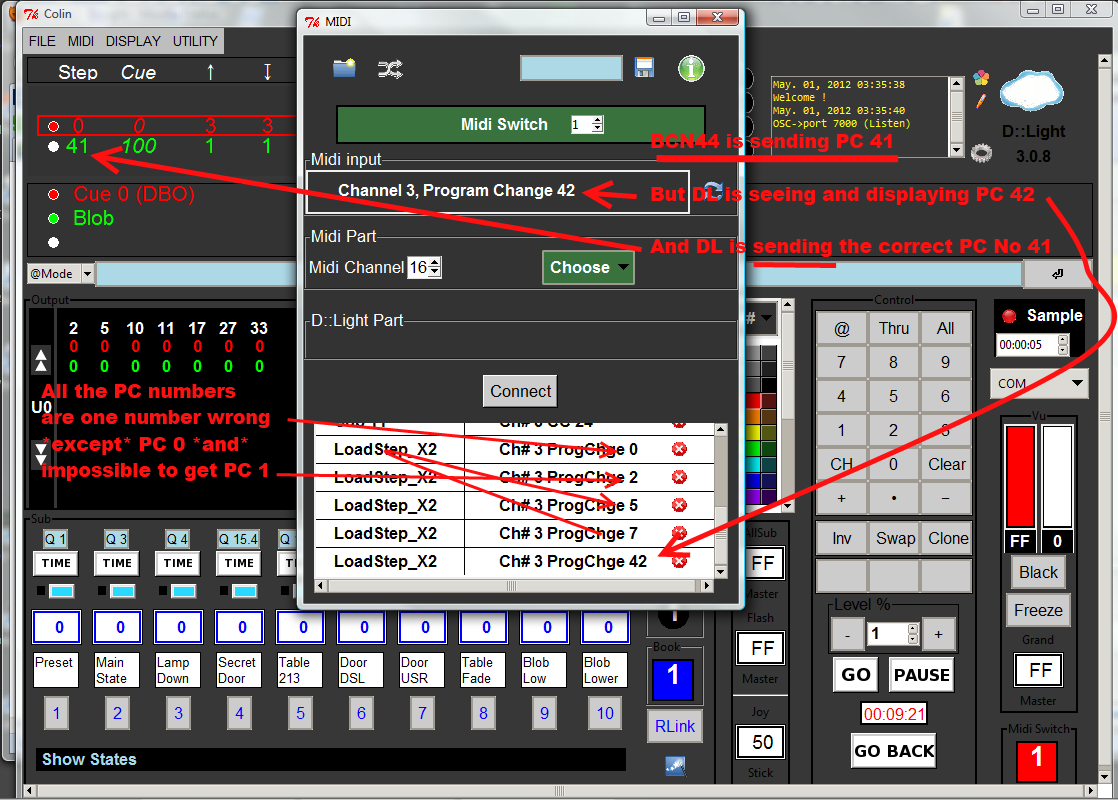

I have a similar experience... 3.0.8, Win Vista HP
Screen shot shows...

14 years 6 months ago #4624 by sl1200mk2
Replied by sl1200mk2 on topic Re: bug avec les program changes
@Colin & Fodor
thanx guys for spotting that,
apparently, and according to Colin picture, my pureData PC out is doing wrong. (midiMonitor is agree with you...)
so i've change the code about PC,
please test and report that point when 3.0.9 will be public (very soon...)
Nico
