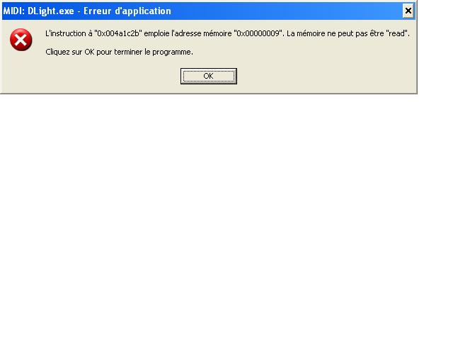

13 years 8 months ago #5800 by xtineb
Replied by xtineb on topic 3.0.12_b8
pt'it crash quand 2nd clic sur "la feuille" blanche du setup MIDI
xtine
13 years 8 months ago #5801 by sl1200mk2
Replied by sl1200mk2 on topic 3.0.12_b8
Hello Xtine,
bien vue pour ce bug, merci!
j'ai appelé cette feuille blanche 'Script' ;-)
13 years 8 months ago #5802 by sl1200mk2
@Xtine,
fixed pour la prochaine béta :)
