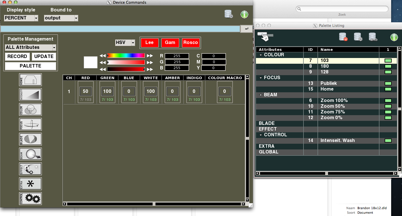

One other thing is how do i edit a pallet?
I select the device commands - palette select pallet nr7. make the adjustments in the device command and select update.
The it say first choose a pallet ????
See Pict 1

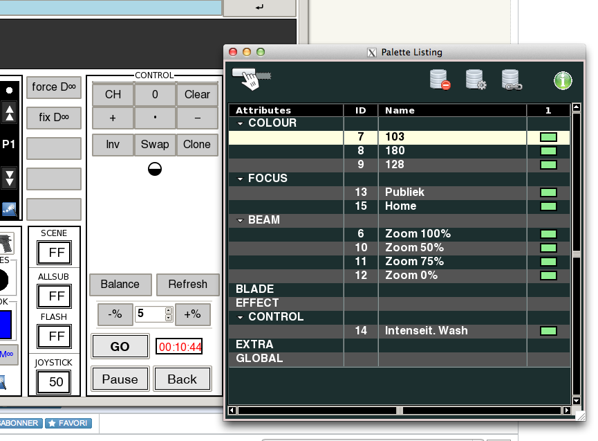

Also how do i get the device commands into the main software bord?
Pict 2
Regards Vincent
10 years 9 months ago #11785 by sl1200mk2
Replied by sl1200mk2 on topic 4.0.0_b56
@Vincent,
you have 2 methods to update a palette:
1) use the palette editor
2) once you have set new values for your device, type the palette number and click update

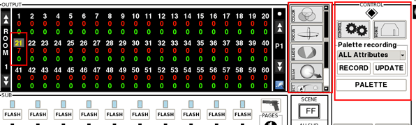

you can't...
all the stuff that belongs to devices is handle in the 'Device Commands' panel.
10 years 9 months ago #11786 by vbs
Replied by vbs on topic 4.0.0_b56
Hi Nico,
I will try that the update part.
About the control panel.
In the wiki at Device it say you can select in the control panel.
Or is this al ready not up to date any more.
Pic. Pallets
