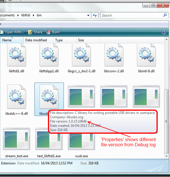

13 years 6 months ago - 13 years 6 months ago #6281 by colinc
Replied by colinc on topic 3.0.15_b7
sl1200mk2 wrote: @Colin
as they've just release their new version of libusbx, can you rerun the test with the libusb attached?
Yes, done and I've attached the log - but -- still get 'Using libusbx v1.0.14.10576' - but see the screenshot
sl1200mk2 wrote: can you also copy it in the DL' bin folder and retry with you ultra DMX Micro
Also did that - still no joy :(
sl1200mk2 wrote: hope you're not tired with these tests...
:P

13 years 6 months ago #6282 by sl1200mk2
Replied by sl1200mk2 on topic 3.0.15_b7
the problem (besides the libusb....14 stuff) is that it tries to use the K drivers and not the WINUSB drivers.
don't ask me why it does not want to use the winusb ones, I don't know.... I've asked the libusbx lists...
