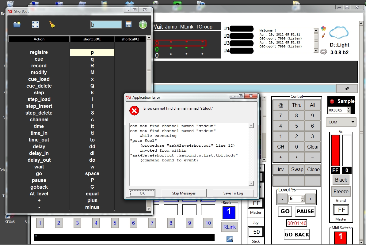

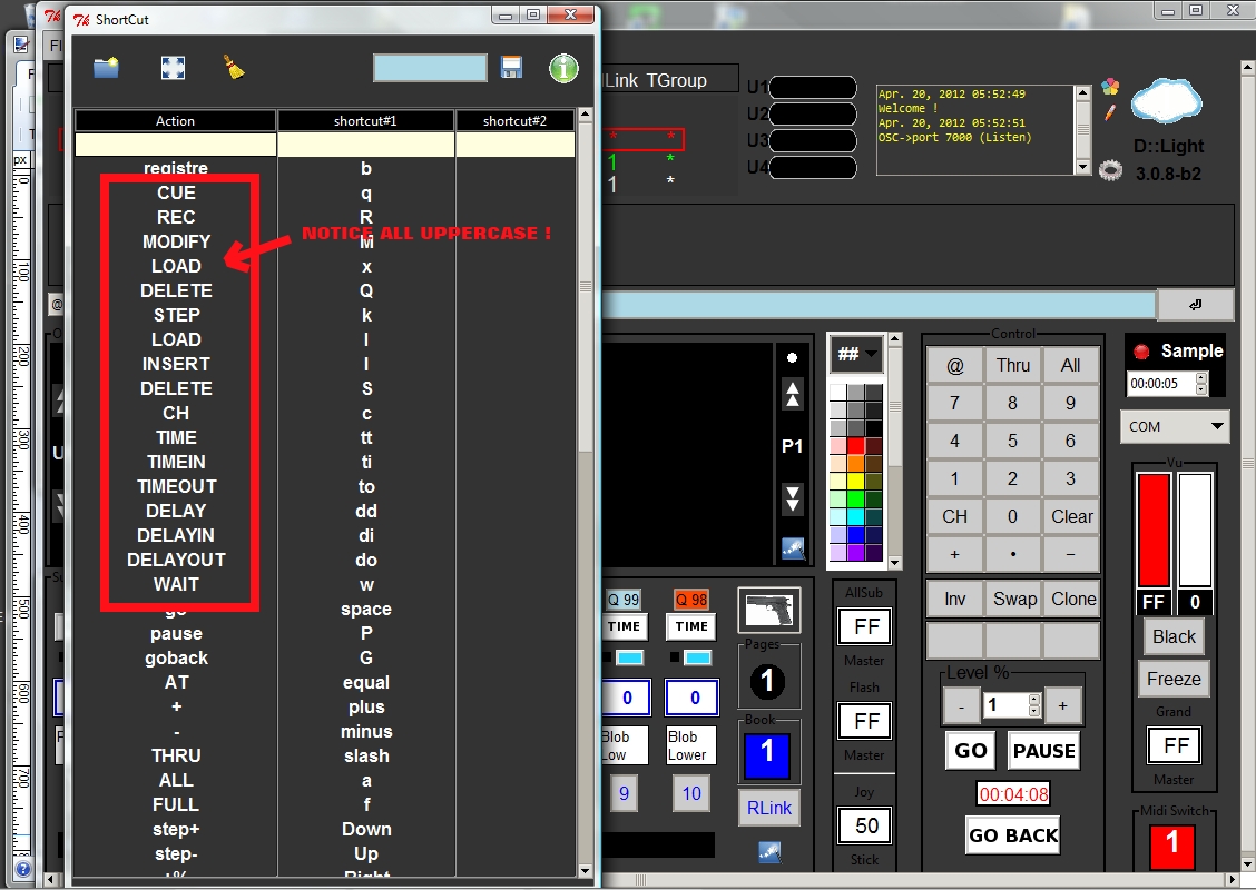

Problems with the Shortcut Window - 2 screen shots show them
1) Previously defined shortcut names from existing file are oddly capitalised - all upper case
2) Attempt to define new shortcuts whether in existing .sho file or File->New cause 'Error : can not find channel named "stdout"
(see screenshot)

for the first thing you mentionned, the Upper case letters, it's a design proposal as in @Mode functions in command line are upper case, i thought it would be fine if shorcuts definitions are upper case too.
does that make sense?
for the error, i've forgotten to remove a debug line.... my mistake...
you can edit DLight.tcl file, find the line with 'ask4Save4shortcut' and remove the line
puts $col
save the file and try again.

14 years 6 months ago #4513 by colinc
Replied by colinc on topic Re: 3.0.8_b2
sl1200mk2 wrote: @Colin
Yes - but if you look at my screenshots, the lower one (with the error message) is a 'new' .sho and has all lower-case, and the upper (a pre-existing .sho file) is a mix of upper and lower case
sl1200mk2 wrote: for the error, i've forgotten to remove a debug line.... my mistake...
puts $col
Yes, that seems to have done the trick. Thank you

@Colin
i do not understand what is the issue.
from a new sho, RPN is the default mode so shortcuts appears lower case. if you change to @Mode, a switch is made, and all available function in @Mode will be uppercase.
'go' stay lower case because it's something not specific to RPN neither to @Mode.
does it make sense?
14 years 6 months ago #4516 by colinc
sl1200mk2 wrote: @boeckel
@Colin
does it make sense?
Ahaah!! Now I see... it was because I had not notice the switch between @Mode and RPN... My beg pardon... But, if I'm honest, although I see your reason, I prefer the lower-case, even for @Mode...
Regards,
