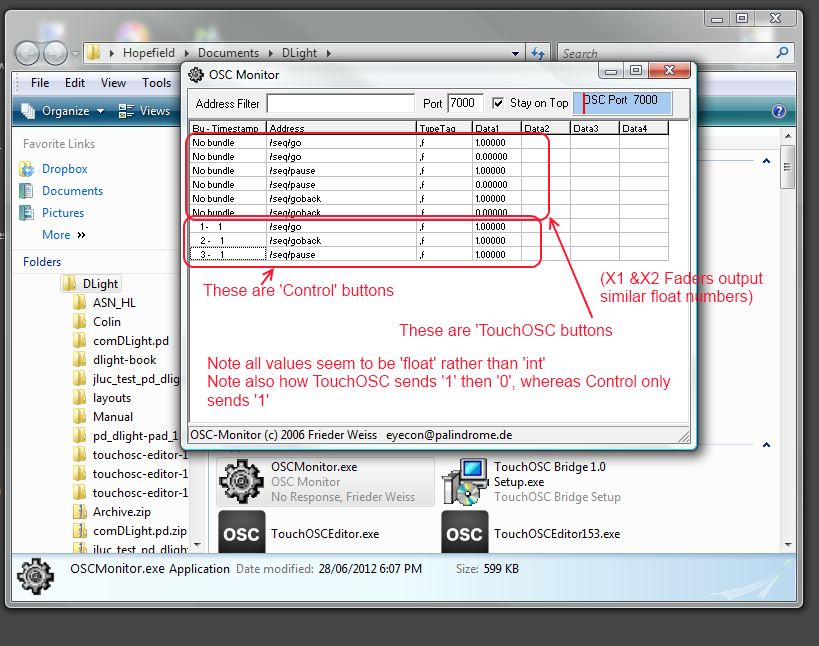

wouldn't you mind trying an OSC monitor ( www.frieder-weiss.de/OSC/index.html googling 'windows OSC monitor) just to see incoming message and if your computer receive GO/GOBACK/PAUSE message as well as X1 or X2 message.
thanx
14 years 4 months ago #4932 by colinc
Replied by colinc on topic 3.0.10_b1
Hi Nico
Results of OSC Monitor can be seen in the attached screenshot image
14 years 4 months ago #4933 by sl1200mk2
Replied by sl1200mk2 on topic 3.0.10_b1
@Colin,
thanx for your analyse,
i think 'll be able to update the 3.0.10_b2 for win tomorrow morning with (i hope) a fix.
